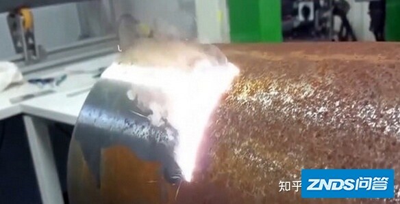

Also, laser energy can be selectively absorbed by coatings,particularly on metal, so CO2 or Nd:YAG pulsed lasers can be used to cleansurfaces, remove paint or coating, or prepare surfaces for painting withoutdamaging the underlying surface. High power lasers clean a large spot with asingle pulse. Lower power lasers use many small pulses which may be scannedacross an area. In industrial application, laser ablation is known as lasercleaning.
而且,激光能量可以被涂层(尤其是金属)选择性吸收,因此,可以使用CO2或Nd:YAG脉冲激光清洁表面,去除油漆或涂层。准备要喷涂的表面和下表面不会损坏。 大功率激光清洁大面积斑点可以通过用单个脉冲。较低功率的激光器使用许多小的脉冲形成区域扫描。在工业应用中,激光烧蚀被称为激光清洁。

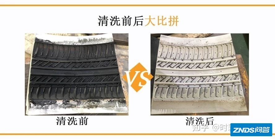

Laser cleaning is also used for efficient rust removal fromiron objects; oil or grease removal from various surfaces; restoration ofpaintings, sculptures, frescoes. Laser ablation is one of preferred techniquesfor rubber mold cleaning due to minimal surface damage to the mold.
激光清洁还可用于有效清除铁物体上的锈;从各个表面去除油或油脂;恢复绘画,雕塑,壁画。由于对模具的表面损伤最小,所以激光烧蚀是用于橡胶模具清洁的优选技术之一。目前时颖激光就已经和享誉海内外的朝阳轮胎,达成合作关系。
